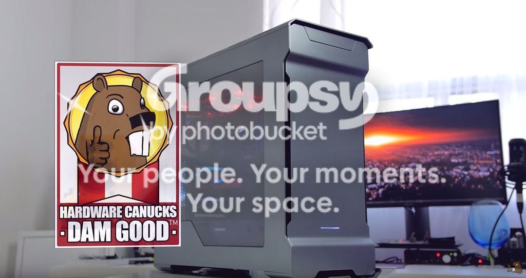

初頭見到師兄出的ITX版開箱,一眼就看上左E個設計,點知原來香港冇得買要係淘寶揾
係YOUTUBE又見到D人話E個機箱堅勁(https://www.youtube.com/watch?v=fQfRDSGlNqI)
而且我而家果個機箱設計真係完全比唔上而家果個...(Cooler master N400)
