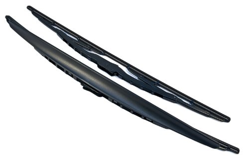

Hello russiaak47,
I had driven a 2014 BMW.
On that BMW, the wiper blades are traditional boned wiper blades.
I asked BMW why that BMW model use boned wiper blades while most German cars switched to boneless?
they told me only boned blades can conform to the curvature of that BMW windscreen.
I didnt believe them and bought a pair of Bosch boneless.
Results? the Bosch boneless could not get my windscreen clean.
Photo of genuine BMW wipers for reference, credit to BMW:

但是由於只有一個支撐點的原因,無骨雨刷的工作條件比有骨雨刷要求高很多,有些車型由於雨刮臂壓力不夠和雨刮電機功率偏小或者玻璃面積和弧度太大,換上無骨雨刷後可能會造成中部翹起,刮不清的情況發生.
可能你架車玻璃弧度太大

    香港用都係去高山德國買啦.正廠3xx.代用Bosch歐洲做都系百幾2百左右一set.
3M果款唔系真無骨.佢只系加咗個擾流殼嘅有骨雨刮.
仲有同之前師兄所講有分左右肽.淘寶買嘅9成系左肽用.如果要買就買Bosch或Valeo多合一接頭版本.呢種個擾流板系中間.所以無分左右肽.
