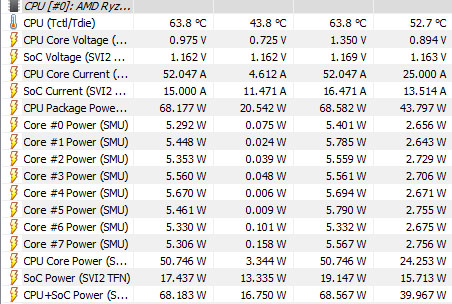

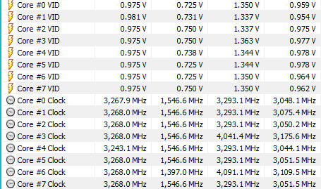

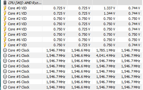

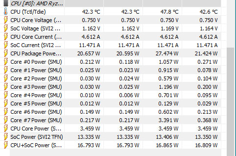

回題: 上到zen+既bios都已經無溫度bug
作者: kcthomlau    時間: 2018-6-27 22:59
R7 2700 stock boost on
Voltage Idle
Temperature Idle
Voltage Aida stability test 1min
Temperature Aida stability test 1min
