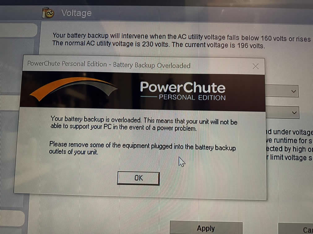

請問各位
隻UPS ES-700 一開Power 制就長響.
換左電池都係咁
請問有人知點處理嗎?
Thanks

作者: dennix    時間: 2023-2-5 05:52
插得太多野,overload,一斷電,你d機已經一秒用晒UPS的電

已經 無插任何野.
插左UPS 電源 一禁Power 制閃幾下 就會長響
作者: 保時捷    時間: 2023-2-5 10:59
196V 係咩事?

1: Disconnect any attached load.
2: Unplug the UPS from the wall socket.
3: Disconnect the UPS' internal battery.
4: Push and hold the ""On"" button on the UPS for 5 seconds
5: Reconnect internal battery.
6: Plug UPS in to known good power source.
7: Turn UPS on.
試下跟下佢做,但網上都見唔少一樣型號都有一樣問題
