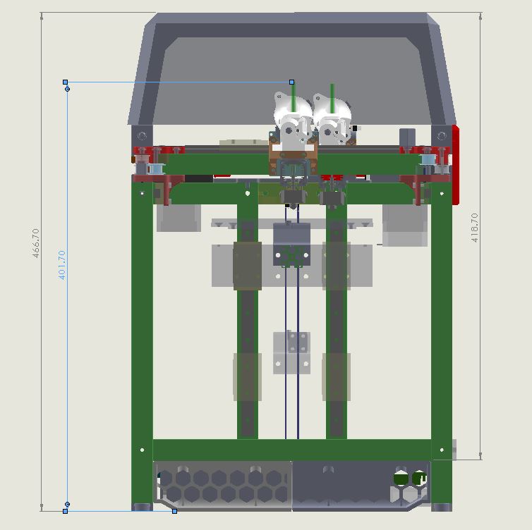

Give you a reference
可能得,用時才用頂蓋,拆蓋入書櫃!
Voron 0.1 (150x150x150) would be best fit..
