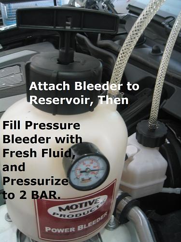

得一個人有無辦法換迫力油?
無人幫我踩放踩放

得一個人有無辦法換迫力油?
無人幫我踩放踩放
piscesho 發表於 2018-5-28 20:21
    I use motive brake bleeder.
Made in USA, so far so good.
Fill the tank, pump it a few times, wait and done by 1 person quickly and better than factory done it:
#Image credit: G-AMG
圖片附件: 3.jpg (2018-9-30 09:46, 37.96 KB) / 下載次數 70
https://h2.hkepc.com/forum/attachment.php?aid=2084446&k=bfa4b0c572695505b20e607e92e7cb45&t=1782848416&sid=1kYzhB9alit
作者: piscesho    時間: 2018-5-28 21:16
回覆 3# PPLd
Thanks for your reply, can I get more information?

作者: PPLd    時間: 2018-5-29 09:46
回覆  PPLd
piscesho 發表於 2018-5-28 21:16
    Hi piscesho,
I dont sell it and I dont work for it.
All I know is it come with adapters for different car brands.
作者: PPLd    時間: 2018-5-29 09:48
