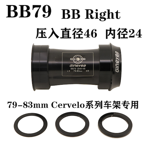

打算買個平價 BB,再換對好啲嘅 Bearing(諗緊用唔用陶瓷),呢隻 Gineyea 有無人用過?外殼造工同用料有無問題?另外想問下 BBright 轉用 Shimano (4624) 嘅 Bearing 難唔難配?Thanks
