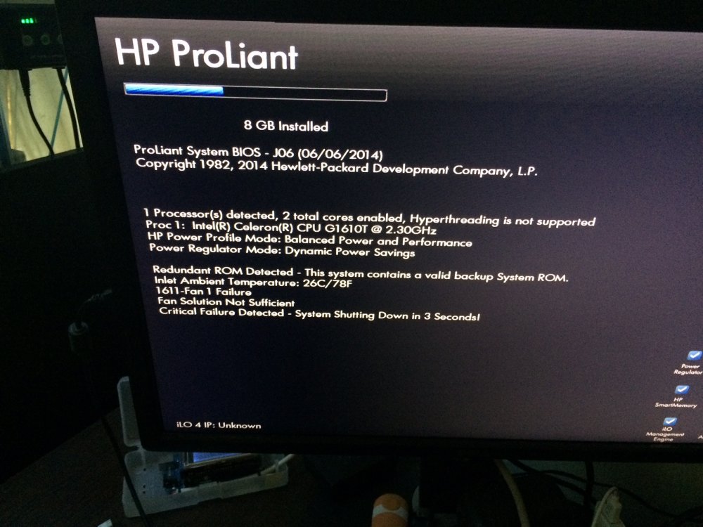

作者: marcolee1314    時間: 2022-6-5 07:17     標題: Microserver Gen8 已死??? :Q .Q
本帖最後由 marcolee1314 於 2022-6-6 22:23 編輯
唔經唔覺都買左6年
上年年中熄左機就無再開
上個月尾開返出error
1611-Fan 1 Failure
Fan Solution Not Sufficient
試個short風扇4,5,6 pin (呃iLO風扇Present)  --> 唔得, 出一樣error
淘寶Gen8風扇換左佢  --> 唔得, 出一樣error
只插一條RAM, 唔插HDD and sata  --> 唔得, 出一樣error
清cmos  --> 唔得, 出一樣error
BIOS update了最新
是否要送去堆填區/EPD了

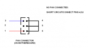

回復 6 #marcolee1314
全部接風扇插頭3,4,5脚都己短路吗?
作者: marcolee1314    時間: 2022-6-6 21:35
本帖最後由 marcolee1314 於 2022-6-6 22:21 編輯
回覆 7# stevenho1
    得一把風扇,4,5,6pin已short
圖片附件: post-8123-0-96842100-1394609702_thumb.png (2022-6-6 22:21, 22.36 KB) / 下載次數 86
https://h2.hkepc.com/forum/attachment.php?aid=2323925&k=281c16b6e69a7170d7457abb8b9cb859&t=1781874508&sid=1gjNa3RKsKQ

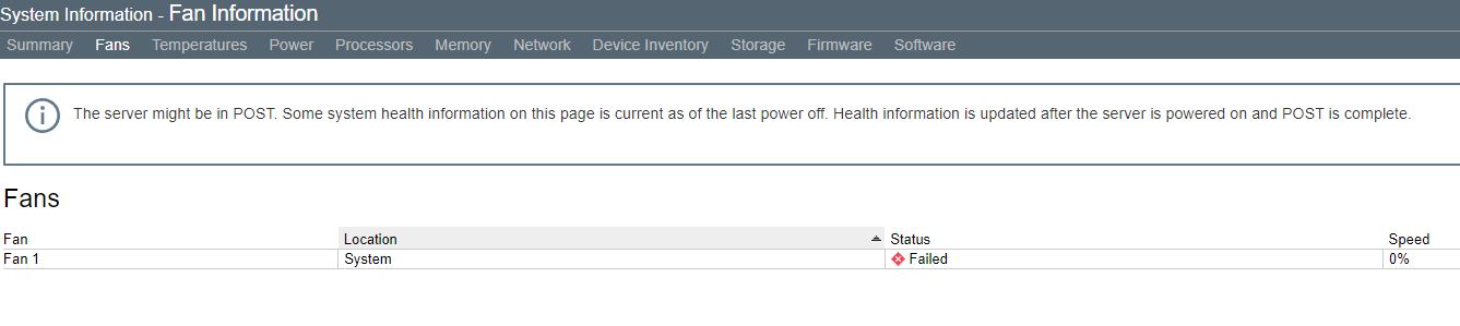

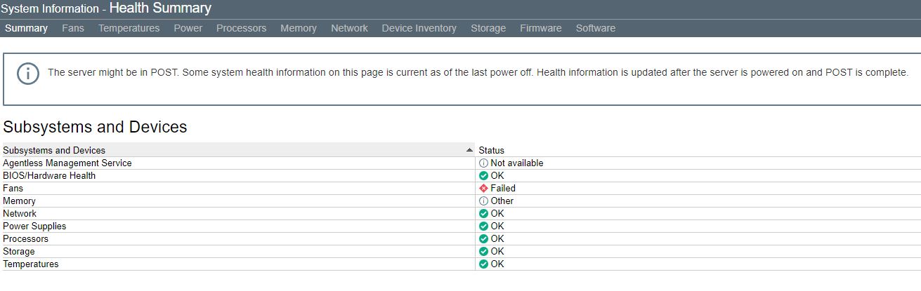

回復 8 #marcolee1314
可以入ILO睇fan status及速度吗?
作者: marcolee1314    時間: 2022-6-6 22:51
回覆 9# stevenho1
圖片附件: summary.JPG (2022-6-6 22:51, 76.97 KB) / 下載次數 86
https://h2.hkepc.com/forum/attachment.php?aid=2323933&k=5c63cf9ff1b12efec0ac7def20cb94e7&t=1781874508&sid=1gjNa3RKsKQ
圖片附件: fan.JPG (2022-6-6 22:51, 49.1 KB) / 下載次數 88
https://h2.hkepc.com/forum/attachment.php?aid=2323934&k=823ec9faaa424ca3da133c26c575c6b9&t=1781874508&sid=1gjNa3RKsKQ

作者: marcolee1314    時間: 2022-6-9 13:22
回覆 12# fred2088
我係用呢隻線不過係DIY
用萬用錶他過係同圖一樣4,5,6 short埋一齊

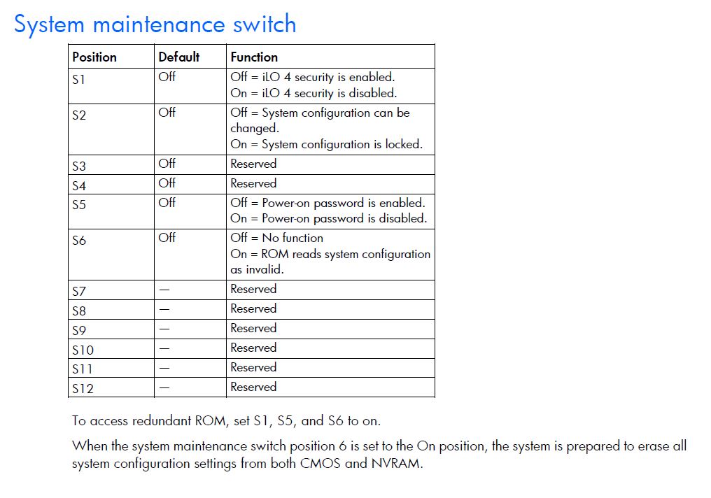

作者: normalyan    時間: 2022-6-9 13:47
Remove the power supply units and swap them.
Test to see if the system will boot...
If that doesn't work:
Remove all power supplies from the chassis
Locate the System Maintenance Switch on the motherboard - It's a set of 10 DIP switches.
Turn switch #6 switch on.
Insert all power supply units.
Power on the server and allow it to idle for 3 minutes.
Power the server off.
Remove all power supplies.
Return DIP switch #6 to off (original) position.
Reinsert the power supplies.
Power the server on.
Turn DIP switches #1, 5 and 6 switch on.
Return DIP switches #1, 5 and 6 to off (original) position.
Test to seif the system e will boot..
If that doesn't work, You need a system board replacement
作者: marcolee1314    時間: 2022-6-10 13:22
回覆 17# normalyan
My Gen8 has 12 Dip switches btw.
I tried your solutions, neither work for me  :(
圖片附件: switch.JPG (2022-6-10 13:22, 94.06 KB) / 下載次數 63
https://h2.hkepc.com/forum/attachment.php?aid=2324434&k=ba75efad54575d178616663f329f976b&t=1781874508&sid=1gjNa3RKsKQ

作者: stevenho1    時間: 2022-6-17 21:23
回復 38 #marcolee1314
風扇轉吗?勞烦量第三脚是不是3.3V及iLO fan speed是不是顯示0%?
作者: marcolee1314    時間: 2022-6-17 21:46
回覆 39# stevenho1
風扇轉吗? -> 有轉
勞烦量第三脚是不是3.3V -> (你指第4pin?)未開機3.2V, 開了機風扇轉時(第4pin(黃線)對地1.72V), (第3pin(藍線)對地1.52V)
及iLO fan speed是不是顯示0%? -> YES , 顯示0%

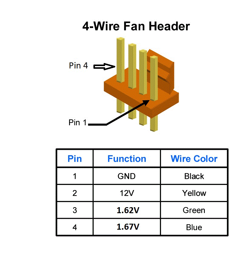

作者: marcolee1314    時間: 2022-6-27 15:52
本帖最後由 marcolee1314 於 2022-6-27 17:19 編輯
回覆 43# stevenho1
最後放棄左Q .Q  拎左部idle既不能說用住先. . .遲D先再整部自組
答返你個問題, 普通PC 4針電壓如下
圖片附件: 0w0.gif (2022-6-27 15:52, 41.01 KB) / 下載次數 75
