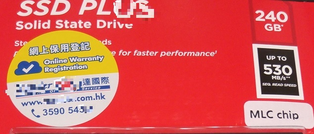

話說小弟尋日買左隻某達代理既240GB 貼住MLC Chip 的SSD
但一開箱裝機check 先發現係 TLC
各位買左呢隻SSD 既朋友唔該check 清楚

作者: ykhk0930    時間: 2016-8-23 14:46
有冇致電代理查問?
作者: 孔明仔    時間: 2016-8-23 14:48
本帖最後由 孔明仔 於 2016-8-23 14:49 編輯
有冇致電代理查問?
ykhk0930 發表於 2016-8-23 02:46 PM
已致電
某達代理
佢地都唔知呢隻唔係MLC
但我想帶出一樣野係呢隻型號唔少人因為佢話係MLC 而買但後來發現原來唔係MLC

作者: yjfoeg    時間: 2016-8-23 15:07
MLC = Multi-Level Cell
雖然MLC普遍係指2-bit Cell
但字面上只要唔係single都係Multi, 佢又冇寫明2-bit

Sandisk SSD PLUS 240GB 曾幾何時係用 MLC NAND,不過今年五月左右已不知不覺間換咗用 TLC 喇

Firmware 睇 z2 定z3
u2 = 19nm, MLC
Z2 = 15nm, MLC
Z3 = 15nm, TLC

今年初我買隻 240G 真係 MLC, 之後再幫人買已經係 TLC.
可能要撞手神....

山敵屎咁鬼鼠以及原廠實知道自己用咩料, 正常唔會劃蛇添足

山敵屎擺明唔講用咩料等自己可以隨時換料. 最好奇邊個畫蛇添足, 網絡早幾個月已唱通天隻 plus 仔換藥.

SanDisk SSD Plus 最早期係用MLC, 後期已經轉左做TLC, 不單止NAND轉左, 而係連主控都轉埋, 可以話已經完全係兩樣唔同野黎

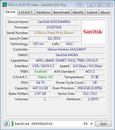

我隻sandisk plus 480gb 係z32070, SSDZ睇係19nm,MLC
咁即係MLC定TLC?
咁即係MLC定TLC?
pong87926 發表於 2016-8-25 03:02 PM
480G
TLC, 15nm NAND
controller: Maybe Marvell or SMT2256S
咁即係MLC定TLC?
pong87926 發表於 2016-8-25 15:02
早兩日都有講
ssdz 係唔識測 mlc or tlc 的, 佢只係用預先人手入好 database show 返 info 出來之麻
ssdz 網站都有講, 重話, 如果果 database 無 or 錯, 幫手 update 返 tim
http://aezay.dk/aezay/ssdz/
Using a database, it will show information about your SSD, such as the controller, processing tech, NAND type etc.
Are the details for your SSD not being shown, or are they incorrect, then please help out. Within SSD-Z, make sure the SSD in question is selected, then go to the Submit tab. Now fill in any comments you may have, and add your email if you wish. Then submit the data to the online database.

早兩日都有講
ssd ...
belleville 發表於 2016-8-25 23:19
it seems ... there is no software in the market that is able to check the 'true' spec (technology, NAND, etc.) of a given ssd
