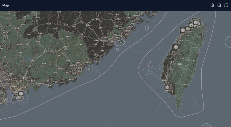

大家有興趣一齊玩Meshtastic嗎? 想係呢到推廣一下!
What is Meshtastic
Meshtastic® is a project that enables you to use inexpensive LoRa radios as a long range off-grid communication platform in areas without existing or reliable communications infrastructure. This project is 100% community driven and open source!
Hardware
我就用Heltec V3 (923Mhz), 用https://flasher.meshtastic.org/ 就可以直接flash firmware
Region
香港我地應該係用923Mhz, 所以要選擇TW (Taiwan)
有香港朋友已經開左香港Channel
PSK: ZA/SIex2+i5evf0LIucP6sRxp6cTJPI5ZoxLJdhUWmM=
現在香港大概有7-8nodes, 要夠多node先可以互相直接通訊, 否則只可以連手機用MQTT通訊
Meshtastic map可以睇到世界各地有幾多個nodes
1. https://meshtastic.liamcottle.net/
2. https://meshmap.net/

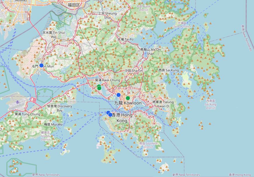

我唔知係唔係正常, Primary Channels 未見過有人出聲, Web API 地圖見到台灣好多node 不過香港得自己

作者: bendoraemon    時間: 2025-1-11 17:45
喺屋企見到自己另外一邊上唔到網嘅裝置, 雖然跳咗三下.
應該係有啲人用
