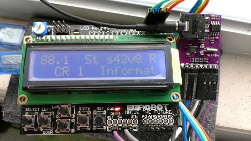

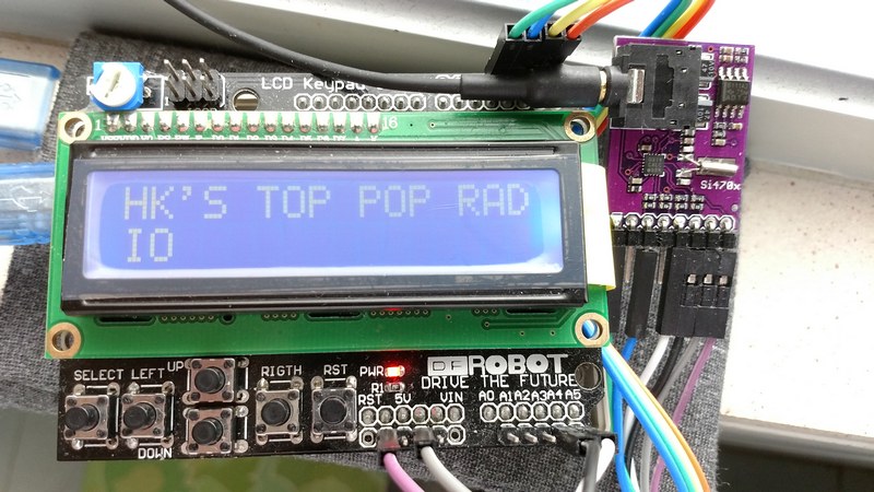

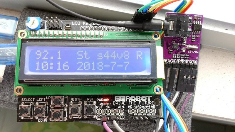

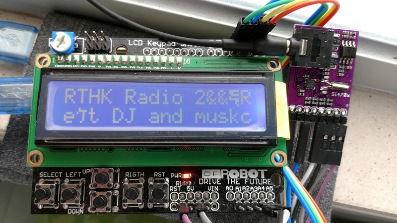

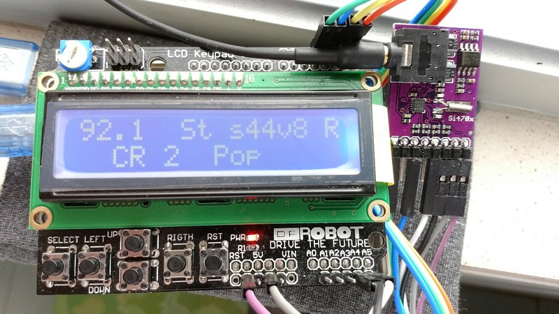

淘左件SI4703 FM 模塊, 斗左成個星期編程至有D成果!可能本身coding 是有限公司及網上參考少,多數library分享流於FM調台等操作.
RDS 用Binary PSK傳送, 1187.5 bps, 每Packet(104 bit) 分4個block(A,B,C,D), 每個block含16 bit data + 10 bit Check & Offset, 即約每87.5mS 讀一次RDS register, 可用polling 或 Interrupt待接收1個packet完結才讀取.
RDS Group list ref: http://www.g.laroche.free.fr/eng ... listeGroupesRDS.htm

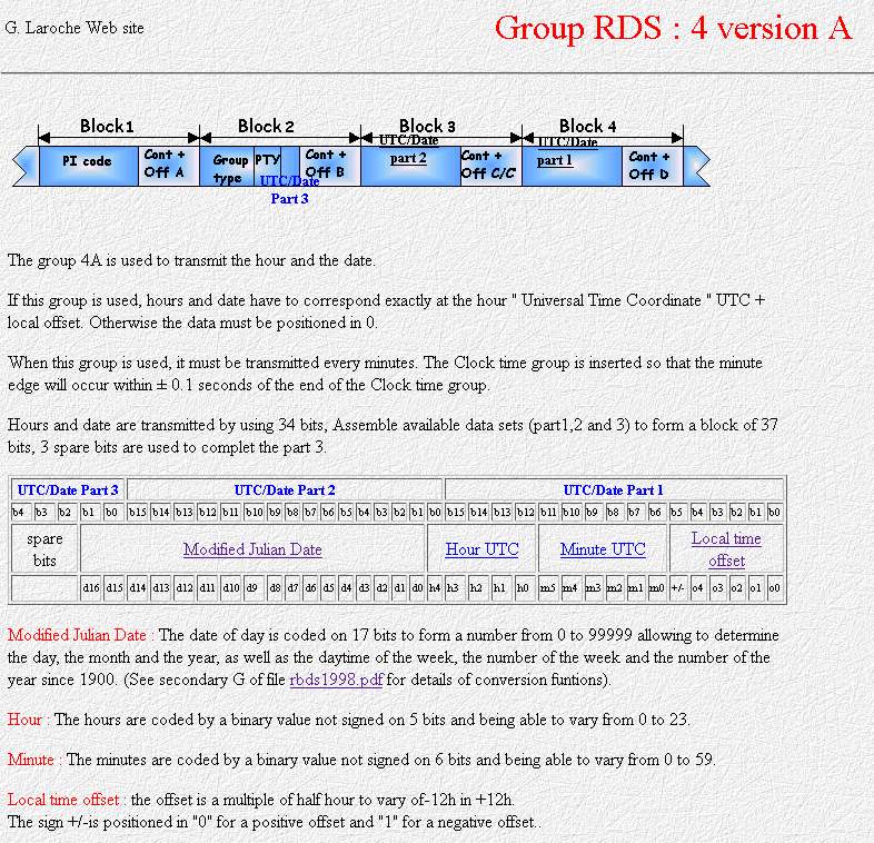

但RDS資訊分16個group,再分A/B版本,即32組合,而日期及時間是4A group的:
ref:http://www.g.laroche.free.fr/english/rds/groupes/4/groupe4A.htm
要近窗邊至收倒RDS訊息:

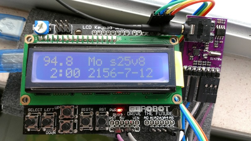

唔知是否用PSK問題 error rate都幾高, SI4703說明最好接收幾次對比確認無誤!

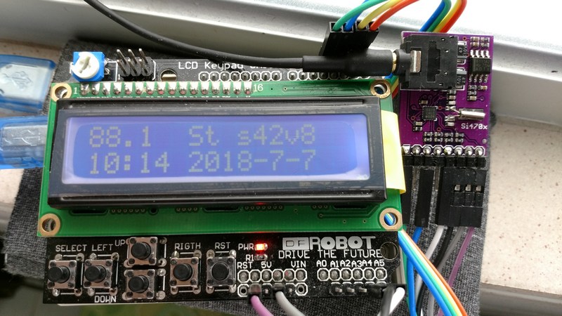

由於傳送資訊沒秒數, 故4A packet (time)只在踏正分鐘數時傳送一次,如果錯失左就要等下一分鐘了
與天文台的網上時鐘對比,CR2 慢了約12秒, RTHK2慢了約3秒, 吾知是否數碼化的Delay
SI4703會將接收訊號強度由0~75dBμV表示 (Received Signal Strength Indicator), 初步發覺要到15dBμV倒至收倒RDS部份,屋內全無反應,或許是這模塊沒天線,只靠headphone cable而已!

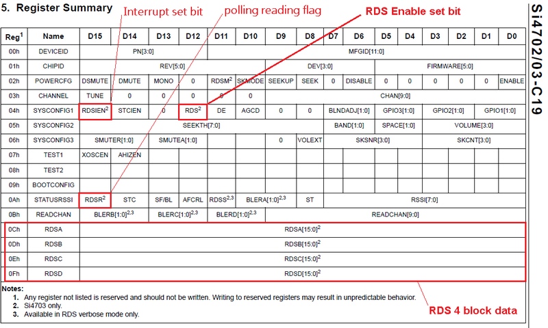

圖片附件: [SI4703 set/read register] SI4703.jpg (2018-7-8 00:09, 148.41 KB) / 下載次數 101

圖片附件: [CR1 ] a.jpg (2018-7-8 00:09, 147.75 KB) / 下載次數 86

圖片附件: [CR1 RDS text] b.jpg (2018-7-8 00:09, 140.5 KB) / 下載次數 98

圖片附件: [CR1 Time] c.jpg (2018-7-8 00:09, 142.98 KB) / 下載次數 104

圖片附件: [Group 4A ] Group4A.jpg (2018-7-8 00:27, 148.37 KB) / 下載次數 104
https://h2.hkepc.com/forum/attachment.php?aid=2069198&k=9b281a048707bbbe7ca641a034639ac8&t=1782261939&sid=tbwjV7pmT

part I:   (回貼最多只可 34995 字,超過了只好分兩部份)
ref: https://github.com/packetgeek/si4703/blob/master/rds.c
RDS: http://www.g.laroche.free.fr/english/rds/groupes/4/groupe4A.htm
uno    |   SI4703          //Connection
pin 3  |   GPIO2            RDS Interrupt
pin 2  |   reset
I2C
Si4703
<< must read/write all register at one time >> (2byte register)
-76 ~ 108MHz
-Automatic frequency control (AFC)
-Automatic gain control (AGC)
-RDS/RBDS Processor
-Volume control
-2.7 to 5.5 V
-RDS Binary PSK, 1187.5 bps, 4 block (each 16 bit data +10 bit Check + Offset), 87.5mS receive a packet to have an Interrupt to reading

void displayInfo(){
  si4703_readRegisters();                                                           //read SI4703 all register data
/* for (int i=0; i<=0x0f; i++){                                                      //for debug, printout all register
    Serial.print(i, HEX);
    Serial.print("  ");
    Serial.println(Si4703_registers, HEX);}
    Serial.println(" ");   */
    float playCH = ((float)((Si4703_registers[0x0b] & 0x03ff)*10) + 8750)/100;     //9:0 READCHAN[9:0] Read Channel. If BAND 05h[7:6] = 00, then Freq (MHz) = Spacing (MHz) x Channel + 87.5 MHz
    lcd.setCursor(0, 0);
    lcd.print(playCH, 1);                                                           //display play channel
    lcd.print("   ");
    lcd.setCursor(6, 0);
    if ((Si4703_registers[0x0a] & 0x0100) == 0x0100){ lcd.print("St   ");}          //Stereo / Mono
    else{ lcd.print("Mo   ");}
    int Signal_level = Si4703_registers[0x0a] & 0x00ff;                             //Received Signal Strength Indicator  <= 75 dBμV.
    lcd.setCursor(9, 0);
    lcd.print("s");
    lcd.print(Signal_level);                                                        //signal level
    lcd.print("   ");
    int volume = Si4703_registers[0x05] & 0x000f;
    lcd.setCursor(12, 0);                                                           //display volume
    lcd.print("v");
    lcd.print(volume);
    lcd.print("   ");
    lcd.setCursor(15, 0);
    if( (Si4703_registers[0x0a] & 0x8000) == 0x8000){                               //check RDS ready
    lcd.print("RDS  ");
    RDS_Ready=1;}
    else{lcd.print("   ");}
    if( RDS_textDisplay == 1){                                                          //display RDS_2A_text[64]

    if( RDS_textDisplay == 2){                                                          //display Time and day
      RDS_textDisplay=0;
      if (RDS_year >= 58000){                                                           //check error, 58303 = 2018-7-4
      lcd.setCursor(0, 1);
      if(RDS_hour < 10){ lcd.print(" ");}
      lcd.print(RDS_hour);
      lcd.print(":");
      if(RDS_minute < 10){ lcd.print("0");}
      lcd.print(RDS_minute);
      lcd.print(" ");
      lcd.setCursor(6, 1);                                                             //ref. https://github.com/mastmees/silicon_radio
      int32_t yp = ( (float)RDS_year-15078.2 )/365.25;                                 // Y' = int [ (MJD - 15 078,2) / 365,25 ]
      int32_t mp = ( (float)RDS_year-14956.1 - (int32_t)(yp*365.25) )/30.6001;         // M' = int { [ MJD - 14 956,1 - int (Y' × 365,25) ] / 30,6001 }
      int16_t d = RDS_year - 14956 - (int32_t)(yp*365.25) - (int32_t)(mp*30.6001);     // D = MJD - 14 956 - int ( Y' × 365,25 ) - int ( M' × 30,6001 )
      int16_t y, m;
      if (mp == 14 || mp == 15) {                                                       // If M' = 14 or M' = 15, then K = 1; else K = 0
        y = yp + 1;                                                                     // Y = Y' + K
        m = mp-1-12; }                                                                  // M = M' - 1 - K × 12
      else {
        y=yp;
        m=mp-1;}
      y+=1900;
      lcd.print(y);
      lcd.print("-");
      lcd.print(m);
      lcd.print("-");
      lcd.print(d);
      lcd.print("  ");

void si4703_readRegisters(){                                              //Read the entire register control set from 0x00 to 0x0F
                                                                        //Si4703 begins reading from register upper register of 0x0A and reads to 0x0F, then loops to 0x00.
  Wire.requestFrom(Si4703_add, 32);                                       //We want to read the entire register set from 0x0A to 0x09 = 32 bytes.
  while(Wire.available() < 32) ;                                          //Wait for 16 words/32 bytes to come back from slave I2C device. We may want some time-out error here
                                                                        //Remember, register 0x0A comes in first so we have to shuffle the array around a bit
  for(int x = 0x0A ; ; x++) {                                             //Read in these 32 bytes
    if(x == 0x10) x = 0;                                                  //Loop back to zero
    Si4703_registers[x] = Wire.read() << 8;
    Si4703_registers[x] |= Wire.read();
    if(x == 0x09) break;}                                                  //We're done!

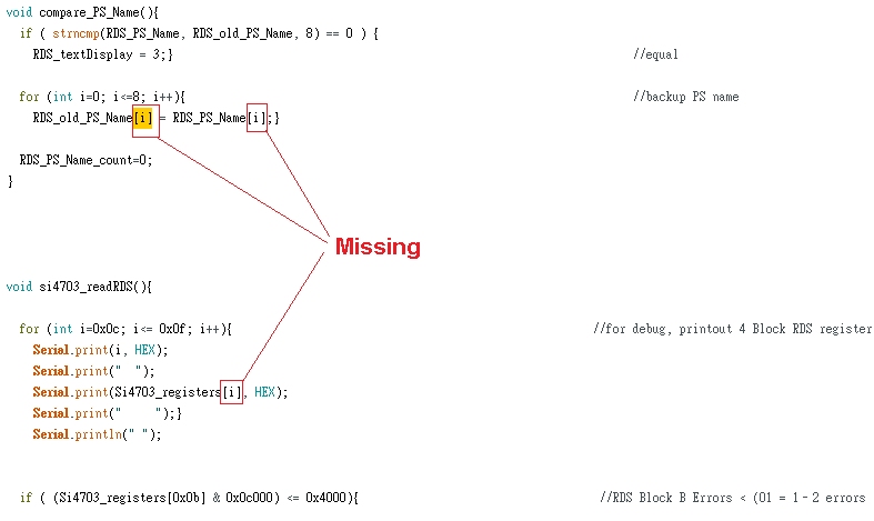

void compare_PS_Name(){
  if ( strncmp(RDS_PS_Name, RDS_old_PS_Name, 8) == 0 ) {
    RDS_textDisplay = 3;}                                                                     //equal
  for (int i=0; i<=8; i++){                                                                   //backup PS name
    RDS_old_PS_Name = RDS_PS_Name;}
  RDS_PS_Name_count=0;

void si4703_readRDS(){
  for (int i=0x0c; i<= 0x0f; i++){                                                      //for debug, printout 4 Block RDS register
    Serial.print("  ");
    Serial.print(Si4703_registers, HEX);
    Serial.print("     ");}
  if ( (Si4703_registers[0x0b] & 0x0c000) <= 0x4000){                                    //RDS Block B Errors < (01 = 1–2 errors requiring correction)
    int i, j;                                                                           //ref.  https://github.com/mastmees/sili ... ster/rdsdecoder.cpp
  switch( (Si4703_registers[RDSB] & 0x0f800) >> 11){                                 //check Group type 0-15, A/B version ref. http://www.g.laroche.free.fr/eng ... listeGroupesRDS.htm
    case 0:                                                                          // 0A
      i = Si4703_registers[RDSB] & 0x0003;                                              //c1,c0 bit    ref. http://www.g.laroche.free.fr/english/rds/groupes/0/groupe0A.htm
      j = ((Si4703_registers[RDSD] >> 8) & 0x00ff);                                     //A line feed " line feed " 0A ( Hex) can be used to indicate to the receiver a change of line.
      RDS_PS_Name[(i*2)] = j;
      j = Si4703_registers[RDSD] & 0x00ff;
      RDS_PS_Name[(i*2)+1] = j;
      if (i == 3){RDS_PS_Name[8] = '\0';}

    case 8:                                                                           //Group 4A, Clock-time and date only,  transmitted every minute, accurate to within 100 ms of UTC
      RDS_minute = (Si4703_registers[RDSD] & 0x0fc0) >> 6;                              //ref. http://www.g.laroche.free.fr/eng ... 4/groupe4A.htm#DATE
      RDS_hour = (Si4703_registers[RDSC] & 0x0001) << 4;                                //hour 5 bits,  from 0 to 23
      RDS_hour = RDS_hour | ((Si4703_registers[RDSD] & 0x0f000) >> 12);                 //minute 6 bits , 0 to 59
      RDS_year = (Si4703_registers[RDSB] & 0x0003) * 32768;                             //Local time offset :6 bit, multiple of half hour, sign +/- = "0" for a positive offset and "1" for a negative offset
      RDS_year = RDS_year + ((Si4703_registers[RDSC] & 0x0fffe) >> 1);                  //year since 1900, 17 bits to form a number from 0 to 99999
      RDS_textDisplay=2;
    break;

作者: hon829    時間: 2018-7-11 20:40
回覆 3# YES_MAN
無長期監察!如時差是恆常的都可調節返見有D政府部門用RDS時鐘的真是相差無幾的!
有RDS車機/HI FI的都可自行比較港台每半小的六下報時是否與RDS時鐘同步!
作者: hon829    時間: 2018-7-11 21:20
本帖最後由 hon829 於 2018-7-11 21:27 編輯
貼了兩次程序,答過我不是機械人,但初步看仍有三處地方少了"", 吾知點解
係所有中括號i 都消失了
圖片附件: Missing.jpg (2018-7-11 21:19, 71.08 KB) / 下載次數 85
https://h2.hkepc.com/forum/attachment.php?aid=2069801&k=2d6c80a8589606e93c4d7825e1cdcdda&t=1782261939&sid=tbwjV7pmT

本帖最後由 C_Law 於 2019-8-14 20:46 編輯
係所有中括號i 都消失了 ...
hon829 發表於 2018/7/11 21:20
因為 [i] 係討論區用作斜字的 BB Code。例如:
[i]ABCD[/i]
會變成
ABCD
貼程式最好用一對:
[code]……[/code]
包住程式碼。
Oooops~~~~~
無留意日子,原來已經係一年前的舊 Post!
