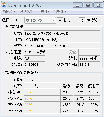

小弟第一次用水冷,眼見其他ching開既po,都係5*6*度左右
點解我呢個會升到9x度,定係呢個溫度已經係正常

1.3136v!!!!  : o

    太高? 正常開turbo係1.23v,唔知點解燒機果陣會上左去1.31

    由第三代i7 開始裏面用散熱膏代替燒Hon,幾勁ge散熱器都會熱。

溫度正常

    所以就要開蓋?

sure not 正常

Check your cpu mount is correct. It shouldn't be so high in temp. I used ITX with 100i only 70 degrees when using OCCT.

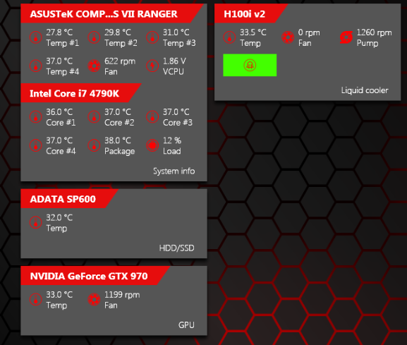

圖片附件: 2.png (2016-4-4 20:13, 125.41 KB) / 下載次數 66

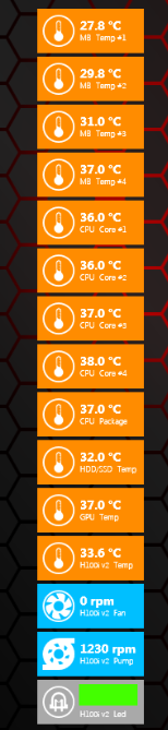

圖片附件: 3.png (2016-4-4 20:13, 57.98 KB) / 下載次數 76

I saw your fan speed are zero. Where did you connect your fans on radiator?

    我見把扇係有轉,唔知點解佢會顯示0轉,燒機果陣就會見到有轉數。待機先無

you better reinstall the pump attach to cpu and take a photo. it should be able to handle 4790k not over 75 degrees. I sold it because it's loud when full load and tubes interfere my memory.

Pump rpm 得1.2K 好似低左D

    燒機果陣會上番2700
