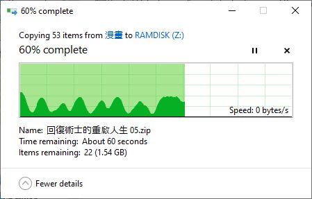

近幾個月發現用 USB 手指,不論寫入定讀取都經常性出現停頓問題。
請問有無巴打知道點樣解決?
試過前置/後置/USB 3.0/2.0 既 port 位,又試過唔同既手指,都出現同樣情況。
底板 : Asrock AB350 Pro4
手指 : ADATA S102 / Lexar Jumdrive S80

this might due to different reasons:
1 windows copying small files
2 usb problems
and others
if u have checked different usb, then this could be the number one reason.
u might want to try copying files from a different harddisk to see if this hdd cause u this problem

這次讀取的檔案大小由 5MB 至 200 MB 不等,基本上80% 以上的都是大於 100 MB 的檔案。
另外系統是 Windows 10。

   I've also had this kind of file copying delay expereince, it was annoying but the process finished itself after an hour, i havent figured out why tho.
I would suggest a clean install if u ask me.

寫入係正常,寫爆slc cache 就咁
讀取就唔正常,有裝防毒就disable 再試
又可以試多幾隻手指睇係咪咁先
作者: normalyan    時間: 2022-8-2 14:13
之前講舊ageas  usb有問題, 試下update最新bios 睇下得唔得...

多謝各位,不過 update 左 BIOS 都無用。
而家再試下有無其他 USB 手指會咁先,唔該晒!
