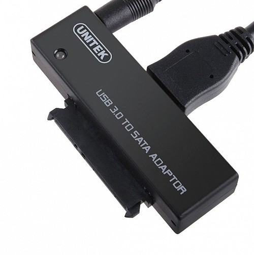

Devices in NTFS:
1. SanDisk Extreme PRO SD UHS-II Card Reader with Samsung EVO Plus microSD 128GB
2. Transcend 25H3 2TB portable hdd
3. HGST 3.5" 2TB + UNITEK Y-1039 with A/C power supply
Device 1
3800D is able to recognize it
Device 2
Previously did a full format in Win 10, no error at all.  It cannot be recognized by 3800D.  Now it's empty and not-in-use.
Device 3
Previously did a full format in Win 10, no error at all.  As it cannot be recognized by 3800D, it was being formatted using 11.8beta3.  It's now fully (almost) loaded with recordings.
UNITEK Y-1039
圖片附件: 500x501x90-Y-1039B-4.jpg (2020-5-12 13:31, 39.07 KB) / 下載次數 36
https://h2.hkepc.com/forum/attachment.php?aid=2192673&k=2a79b0bf965585286868b1d0e4ff3944&t=1781851011&sid=1ijye0EiEA7
