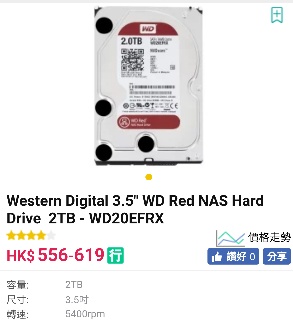

作者: ltho3k    時間: 2019-2-20 08:42
本帖最後由 ltho3k 於 2019-2-20 09:22 編輯
回覆 4# anon893
    WD red 上面個款得唔得。Tks

作者: anon893    時間: 2019-2-20 14:13
我見Magic TV 机用Toshiba hard disk.
lnchu 發表於 2019-2-20 01:03 PM
It depends on available inventory
PM procures different brands of HDDs depending on season
But in any case, a video-specific HDD should be applied to the MTV and NOT just any cheapskate HDD
作者: anon893    時間: 2019-2-20 14:15
回覆  anon893
WD red 上面個款得唔得。Tks
ltho3k 發表於 2019-2-20 08:42 AM
Seriously, I don't know
I would probably slap in a Gold or better instead
Maybe check this thread for some inspiration
https://forums.tomshardware.com/ ... eo-editing.3088091/
作者: wklie    時間: 2019-2-20 15:54
本帖最後由 wklie 於 2019-2-20 15:56 編輯
回覆 5# ltho3k
Any ordinary SATA HDD no larger than 4TB should work for replacing the Magic TV internal HDD.
After purchasing a new SATA HDD, format it using a computer first, so that it is not empty of partition, before letting it re-format by Magic TV.

作者: anon893    時間: 2019-2-21 11:29
回覆  ltho3k
Any ordinary SATA HDD no larger than 4TB should work for replacing the Magic TV inter ...
wklie 發表於 2019-2-20 03:54 PM
Some member here has replaced such internal HDD with a 8TB capacity model and has yielded no problem whatsoever... How can you explain that?
Also, how come the MTV's HDD formatting command is such buggy?  I mean, why format the HDD under PC environment just to create a partition?  How come MTV cannot do that while formatting the HDD?
作者: wklie    時間: 2019-2-21 16:55
本帖最後由 wklie 於 2019-2-21 17:00 編輯
回覆 12# anon893
1. I have good reasons to believe 4TB and smaller drives should work.  If a user finds that 8TB also works as system HDD, good for them but this is neither officially tested nor guaranteed.  Format of USB HDD has another limit.
2. The format function actually rewrites the partition table.

作者: ltho3k    時間: 2019-2-23 17:26
回覆 4# anon893
Finally purchase purple 3T. Thanks
作者: anon893    時間: 2019-2-24 17:00
回覆  anon893
ltho3k 發表於 2019-2-23 05:26 PM
Seriously though, I dun see the advantage of a 3TB capacity over a 4TB...
With such applications as MTV perhaps a 4TB would be a better choice, becuz you just don't know when you'll end up filling up the drive fast with all the recorded programs
But anyway, now that you got the Purple 3TB, the next step will be to follow the instructions for formatting and mounting it into the MTV to see if there's any problem

作者: ltho3k    時間: 2019-2-25 11:55
本帖最後由 ltho3k 於 2019-2-25 11:57 編輯
回覆 17# wklie
因隻3T 有D問題, 最後換左蒦普通版 WD 2T . 顺利使用中, sales 話 format 唔到, 可能係win 7 只support 2T. 要用其他software 先format 到,。
作者: anon893    時間: 2019-2-25 15:03
回覆  wklie
因隻3T 有D問題, 最後換左蒦普通版 WD 2T . 顺利使用中, sales 話 format 唔到, 可能 ...
ltho3k 發表於 2019-2-25 11:55 AM
w7 supports >2TB HDDs if formatted in GPT
普通版 WD 2T is basically another Green POS
I think it's wrong for you to downgrade... should've stuck with another Purple but in 2TB capacity
作者: ltho3k    時間: 2019-2-25 15:16
回覆 19# anon893
Thanks. 下次有機會再换。。 By the way, 上次我買,Toshiba 3T
    Hardisk 都可以响 Magic Tv format. 今次WD 3T 就电腦同magic t.v. 都 format唔到。。
作者: anon893    時間: 2019-2-25 15:27
本帖最後由 anon893 於 2019-2-25 15:29 編輯
回覆  anon893
    Hardisk 都可以响 Magi ...
ltho3k 發表於 2019-2-25 03:16 PM
Then maybe your Purple 3TB is a lemon, not unusual but considering Purple is a more robust (if not exactly enterprise grade) HDD lineup the QC should've been much robust as well
IMO with standard grade HDDs in MTV applications, bad sector building is a really big problem
Not that pro-grade HDDs are immune, but such error may be less likely (also depending on how you treat your HDD during recording and playback)

作者: wklie    時間: 2019-2-27 11:10
回覆  anon893
ltho3k 發表於 2019-2-25 15:16
Windows 7 must be able to format a 3TB HDD.  If it can format other HDD but not this particular 3TB, there must be a hardware fault with the HDD, or the SATA cable is failing (which is less likely).
