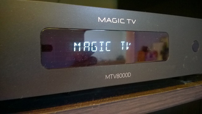

作者: william6373    時間: 2016-5-24 20:45     標題: MTV一過保養就...
有無C兄知咩事?
圖片附件: WP_20160524_009.jpg (2016-5-24 20:44, 90.6 KB) / 下載次數 57
https://h2.hkepc.com/forum/attachment.php?aid=1892296&k=bb7b6e2d8c7f2872ee2baacac397fd29&t=1782401546&sid=6MZ7MG33ziA
作者: wklie    時間: 2016-5-24 21:18
回覆 1# william6373
Unplug power cord.
Open up the Magic TV and disconnect system HDD cables.
Retry.
If you have another 12V 4A power supply, try that too.

作者: william6373    時間: 2016-5-24 22:56
回覆 2# wklie
多謝c兄提供,反正剛過保,聽日試下再上泥匯報
作者: william6373    時間: 2016-5-24 22:58
回覆 4# pc1668
  Yes
Freeze display at startup

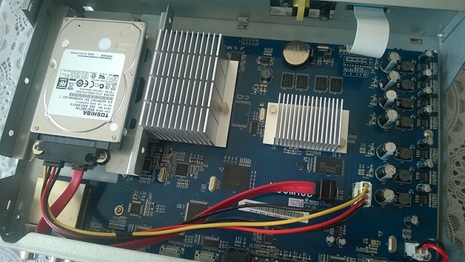

作者: william6373    時間: 2016-5-25 10:33
買左3A牛
換2032
新HDD
都係唔得
special thank to wklie c兄
圖片附件: WP_20160525_002.jpg (2016-5-25 10:31, 144.93 KB) / 下載次數 58
https://h2.hkepc.com/forum/attachment.php?aid=1892420&k=e352d7e19452889dac6b4dae6ea8504b&t=1782401546&sid=6MZ7MG33ziA

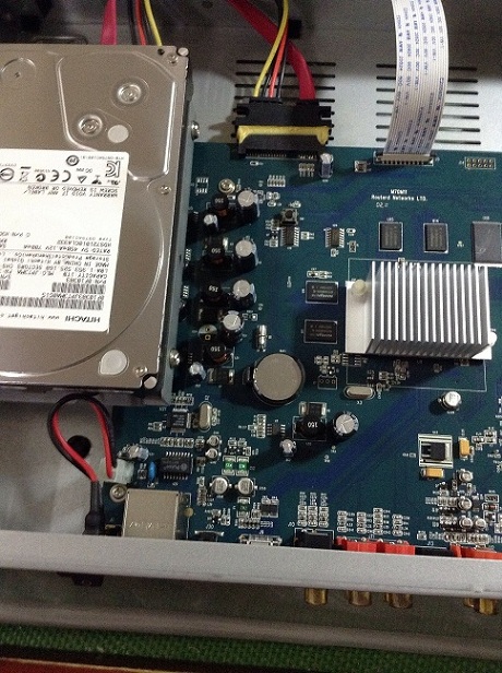

作者: 雯雯    時間: 2016-5-25 23:36
回覆  william6373
Unplug power cord.
Retry. ...
wklie 發表於 2016-5-24 21:18
o岩o岩試o左都係唔得, 唯一發現跟機HDD係Hitachi, 唔係死雞或WD Green.
圖片附件: QQ图片20160525233038.jpg (2016-5-25 23:34, 139.93 KB) / 下載次數 16
https://h2.hkepc.com/forum/attachment.php?aid=1892568&k=f09f84d3e5861a5739d7d2aec0274512&t=1782401546&sid=6MZ7MG33ziA
作者: wklie    時間: 2016-5-25 23:41
回覆 35# 雯雯
Please take it to Science Park to have free checking and get a quotation of repair costs.
